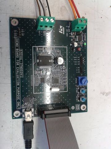

> When I connect the usb port, I don't see the com port
If the com port is not enumerated I think it is a problem of USB-SERIAL bridge. I remember that some prototypes (relized before the final production) have some issue of this type. Can you share a picture of your board. Ciao Gigi2012-09-27 12:13 AM
2012-09-27 12:29 AM
It is absolutely the final version, and so it has been tested afetr the production. Probably you have some issue with driver/operating system.
When you plug the USB cable the windows find new hardware? You get some error message like USB device not recognized? If you get the message that the hardware is ready to be used I think you can see in the device manager the ''Ports (COM & LPT) -> Silicon Labs CP210x USB to UART Bridge (COMxx)''. And you have to set this COM port in the MC workbench. I'm using WinXp and it works. Can you try on different PC/OS? Ciao GigiWe’re moving the ST Community to a new platform to give you a better and more reliable community experience.
