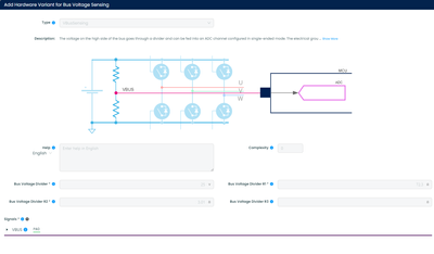

Bus voltage feature has to be defined on your board description and aligned with your hardware (EVSPIN32G4 example):
If TIMx_BRK_M1_IRQHandler() is called, you have to check why OCP occurred. Check if the Current Sensing Hardware Variant parameters (gains, shunt) are aligned with your HW, verify the RShunt voltage level, ...
