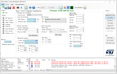

Workbench Settings

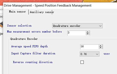

2. The motor sensor configuration is as follows (auxiliary sensors not activated).

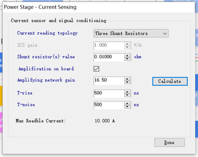

3. The parameters for the current sensor are as follows (after testing, the current readings are correct).

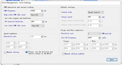

4. The PI (Proportional-Integral) parameters are as follows (using system default settings).

1. I can use Motor Profiler to run the motor.
2. Switched the UVW phase sequence, but it was ineffective.

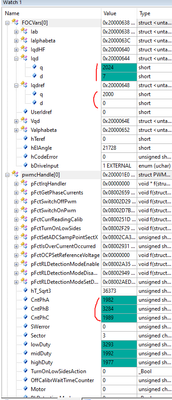

3. In torque mode with a specified Iq, the internal parameters of the motor are tracking normally, but the three duty cycles just stabilize around the set values, unable to run the motor.
