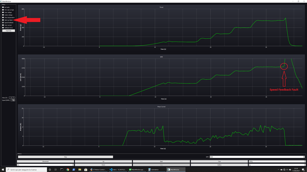

2021-04-11 2:03 PM
Thank you Alexander,
I tryed to increase the execution rate from 1 to 2 for the flux and torque regulator, but then my motor fault at the beginning
of the startup phase.
The strange thing is that if I spin my motor without propeller I can reach 9000rpm before a "speed feedback" fault,
instead when spin the same motor with propeller I can only reach 7000rpm before a "speed feedback fault.
I don't understand why the same fault at different rpm.
