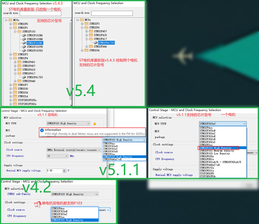

First time I planned to use the MCSDK v4.3 to design my motor driver, and luckly it support F103 in dual motor application. (The chip choosed list showed )
刚开始,我计划使用MCSDK v4.3去设计我的电机驱动,�?�常幸�?,MCSDK v4.3的dual motor模�?支�?F103(在它的芯片选择列表里�?�以找到F103)
After while, I got a new idea——"the newest MCSDK may have fewer bugs as the ST had improved it", so I dowloaded the newest version MCSDK v5.4.3 and found that it's dual motor model do not support F103 in dual motor application. (can't find F103 in chip choosed list )
过了一会儿,我有了一个新的想法——“最新版本的MCSDK应该会有更少的错误,因为ST公�?��?�级了版本,完善了它�?,所以我下载了最新的版本MCSDK v5.4.3,然�?��?�现它的dual motor模�?�?支�?F103。(在它的芯片选择列表里找�?到F103)

Hi LYang
Should I use a F103 or F4 to drive dual motor? Whice one is a better choice?
The new MCSDK 5.x does not support anymore the dual drive motor for F1 series.
If you use your own algorithm, I advise you the F4, but the best choice is a F303 or a G4.
Why did ST company cancel support for F103 in the dual motor mode of MCSDK v5.4.3? (It was originally supported in v4.3?)
The main reason is that the MCSDK aims to configure ST board, and the STM32F1 evaluation board supporting dual motors are not recommended for new design.
F1 is now prety old, and we introduced new products more dedicated to motorcontrol. like F3 and G4 that supports dualdrive too.
Is there any document of website can I find the difference between v5.4.3 or v4.3
The main motivation was to switch to the new library HAL/LL.
v4.3 is now end of life. FW architecture has changed, and code is now generated based on your config making it much more readable.
