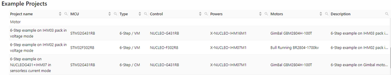

If you open MCSDK 6.4.1, there are several example BLDC related projects.

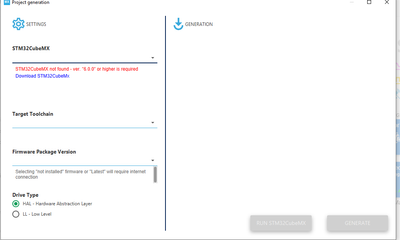

As I have already installed but I am unable to generate a project from example project.

2025-12-16 2:00 AM
As the image mentions you have to install the software's related to code generation, there are some posts in the community regarding the issues in code generation, maybe you need to refer them.
