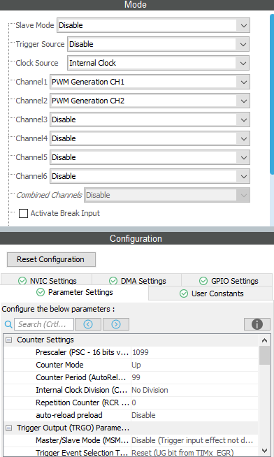

Below is an image of the timer configuration for the PWM drivers in question.

edit: Based on further research, I tried enabling auto-reload preload, but that hasn't fixed the problem either.
