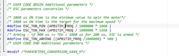

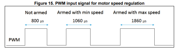

2023-04-05 3:48 AM
Hi Zied,
I hope you are well!
I have mostly got things working, but I need to now try and use the ESC with a different PWM input, from an RC Controller. The Datasheet only mentions the specific timings you mentioned above- 800us, 1060us and 1860us, is there a way of changing this, as well as the expected PWM rate, from the 490Hz rate mentioned?
From what I know, the software allows the internal PWM generation to be changed, but I haven't seen a setting to alter what external PWM input it expects. Once this is sorted, the system should all be done!
Many thanks,
WB
2023-04-05 4:01 AM
You will find these values in the "parameters_conversion_g4xx.h" file, as you can see in the image. Do not hesitate to confirm with me if everything is working correctly.
