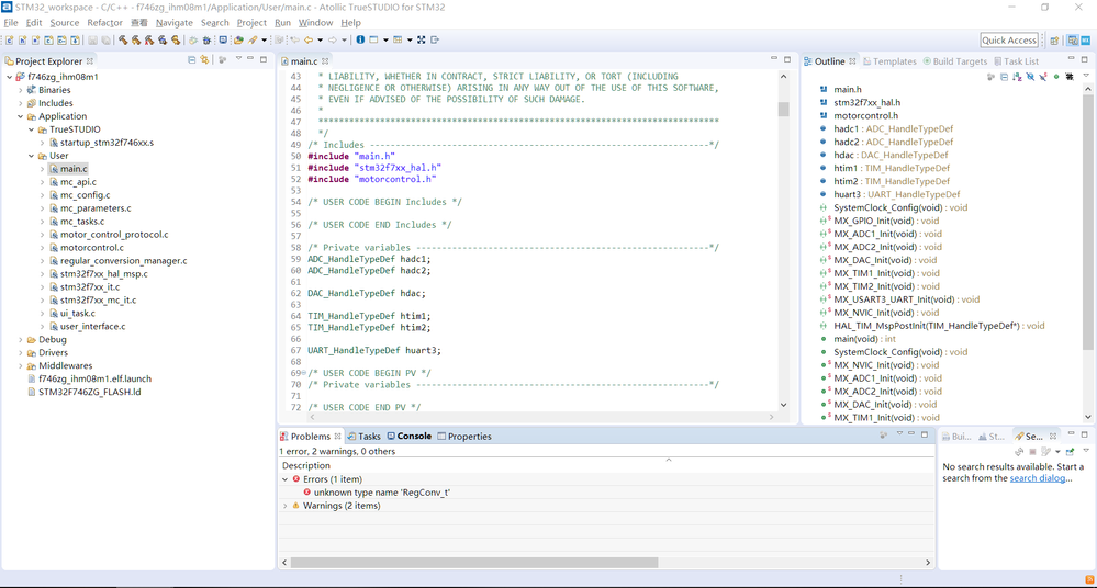

I'm trying to run my motor with a nucleo F303RE and IPM08B but I can't reach a succesful compiling. I tried with X-CUBE-MCSDK 5.1.1 and 5.3.3 and cube 5.0.1 and 5.1.0 without a succesful result. When I try to compile the atollic gives me a lot of errors like:
unknown type name 'RegConv_t' and when I compile it again it returns me some more crazy errors like: unknown type name 'uint8_t'
Seems like it's not importing the libaries correctly but I tried to import It by multiple ways. I find in a user manual that MCSDK 5.0 had some kind of problem with TrueStudio. Does anyone have the 4.x.x version and can tell me where I can download it?

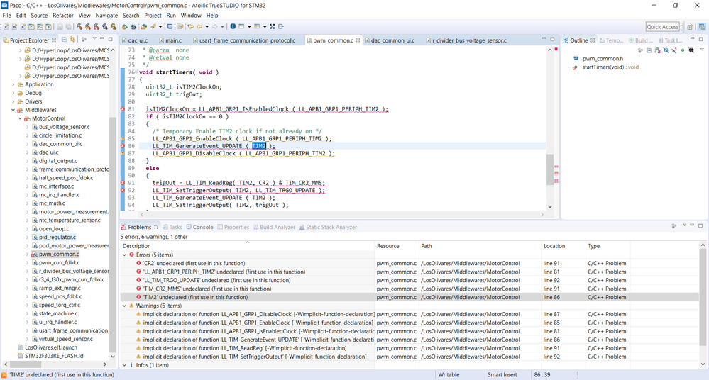

Please, can anyone help me, I tried with IAR, SW4STM32 and ATOLLIC with the same results:
I don't know if it's problem of the compiler, Cube or MCSDK

I have also the same problem, I'm trying to run my motor with nucleo F746ZG but can't reach a succesful compiling. After generation of the project with MC SDK 5.3.3 and configuration of the pinout with CubeMX 4.27.0 without error. But wenn I try to build 'Debug' for project , Atollic TrueSTUDIO warning an error:
"Description Resource Path Location Type
unknown type name 'RegConv_t' f746zg_ihm08m1 line 52 C/C++ Problem "
how can I solve this problem?
