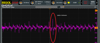

I am measuring the phase current signal, in between i see sudden spikes and the motor halts. I am testing at 60V battery input. It is hall based system and FOC.
It is a custom board and i have not configured the motor pilot, 2 questions if you can answer it will be helpful
a. If i am reading the phase currents at the middle of the low side pwm then it shall be consistently reading the same value but why suddenly it reads invalid value i do not understand i mean the spike.
b. If it is low inductance value should i mandatorily switch at 20KHz at present i am doing at 15KHz. What best i can do to identify the root cause.
Please advise based on the inputs i can move forward.

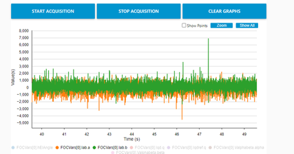

I have made the following changes in the code
#define MAX_MODULE 15000
so the maximum voltage applied is 15000/32767*60V = 27.4 V
The switching frequency i have reduced to 10KHz from 15KHz
i have noticed improvement and the motor is running but some issues still bother me
a. In between there are current spikes and there is audible noise for motor when this happens, i know it is invalid switching. I took the cube monitor data the same is observed. How do i resolve this issue?
b. What will be the impact of the PWM change i have done. I dont here any audible noise at 10KHz. Can i continue with it? Please advise.
