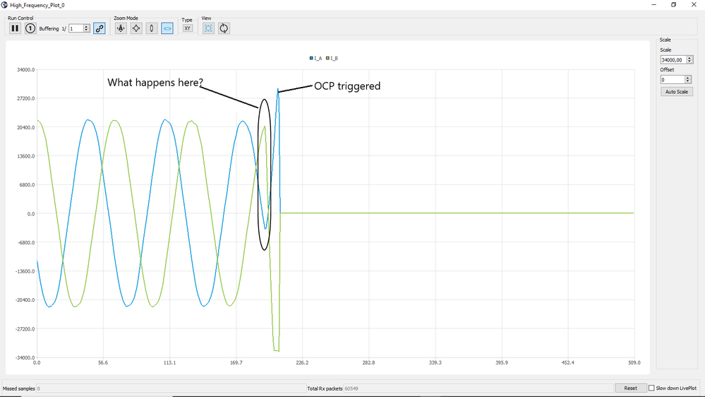

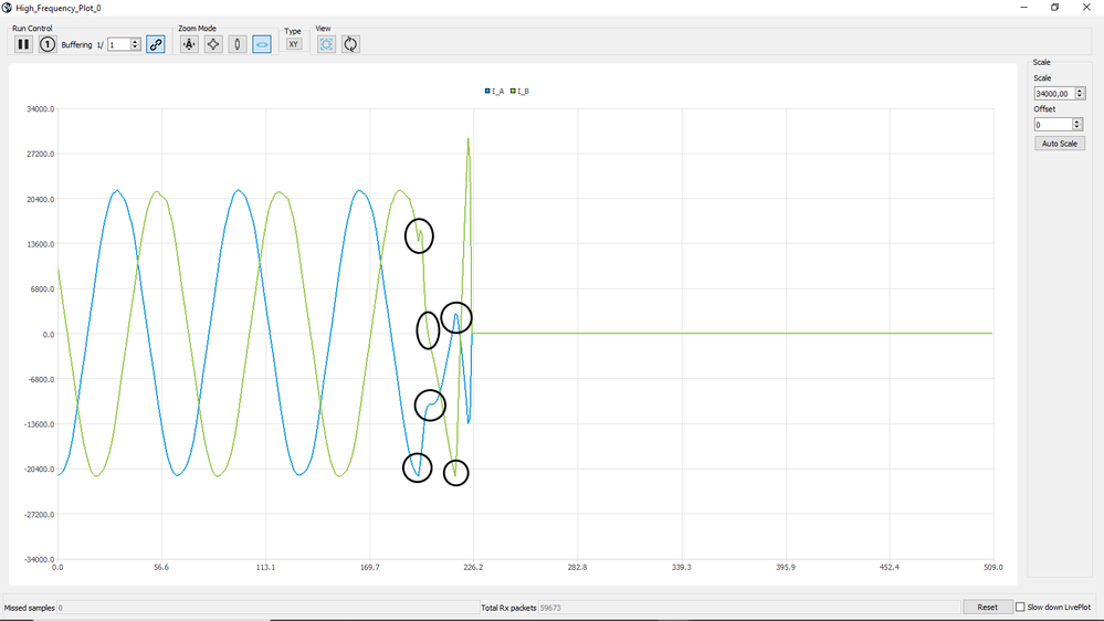

If we inspect the HighFrequencyPlot looking at Ia and Ib, we can see that something is happening right before the currents reach IQMAX . (see the second to last waveform, inside the circle)

Here is a screenshot of Ia and Ib when we have VBUS 600V, 1800rpm. 0693W00000WKSH8QAP.png
Just to be clear; the Overcurrent fault is not what we worry about, in fact, it is probably what is protecting our system. The small dips and inconsistencies in right before the peak+shutdown is the problem that we can't figure out.
