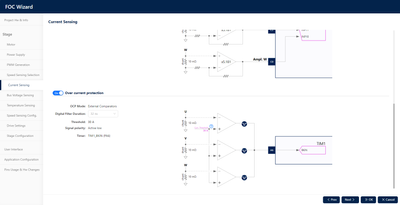

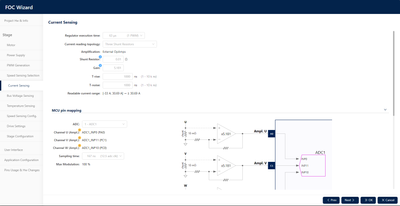

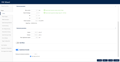

I always encounter a "Over Current" fault once I click the "Start" button.
I have traced my phsae current by current probe, but it is shows less than 1A.
I have no idea what problems it is, has anyone can resolve it?

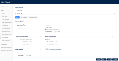

I list my platform and configuration as follows:
1. Motor Control Workbench 6.3.0
2. CubeIDE: 1.15.1
3. Control Board:NUCLEO-H563ZI
4. Power Board:X-NUCLEO-IHM08M1
5. Motor: SPMSM, 40V, 12A with an Encoder, 4096 cnts per revolution
Also, I have modified the HW configuration base on document description and workbench description
The other workbench configuration is listed as follow:

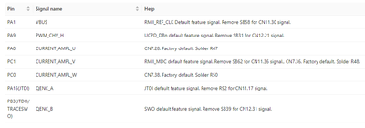

Hello @yang2,

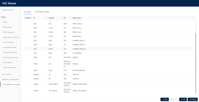

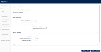

On Workbench "Pins Usage & Hw changes>Hardware Changes" tab, some HW modifications on NUCLEO-H563ZI board are mentioned like for PC1 connection used by CURRENT_AMPL signal. PA1, PA9, PA15, PB3 inputs require also solder bridge or resistors to be removed.
2024-08-22 5:45 AM
Dear GMA,
Thanks your reply, but I have already solder and remove the resistor per Workbench mention.
Just as follows,
Best Regards,
Fan
