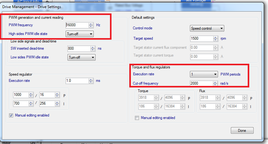

2021-05-09 10:12 AM
This is all you will need to operate the motor.But once you start playing with the software you will be accurately operate motor.
2021-05-09 10:55 AM
Many of Thanks for update...
@Fkadr.1 (Community Member)
1) Means these 10 parameters (as attached) is sufficient to spin the motor ? Rest should be default in mcsdk 5.4.6 ?
2) How to choose PWM Frequency and Execution Rate ? According to Motor Parameter ?
Any other suggestions ...
Karan
