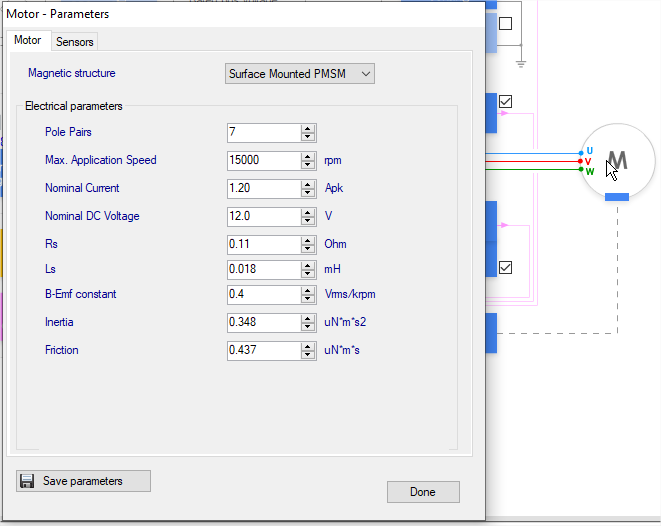

no the engine parameters I have not changed them, I left them by default! maybe they are the ones to change?

According to this Odrive document, the Phase resistance is 0.039ohm, BullRun has 0.11ohm e.g.
I didn't check carefully, but Inductance seems to be missing in the document...

I tried to change the resistor parameters 0.039, but it keeps giving me the same problem ......

other thing i noticed that this engine is not surface psms but it is internal psms!
