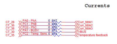

I'm having trouble understanding what the instruction below wants me to do.....
It says: "Solder R47".
-On which board?
-Solder it where?
-What value is the resistor?

Dear sgordon777,
These warnings only point out that R47, R48 and R50 from IHM08 must be present in order to have current signals available. From X-NUCLEO-IHM08M1_schematic.pdf document.

Thanks! Just realized that schematic isn't searchable (its an image) which is why my search yesterday turned up nothing
