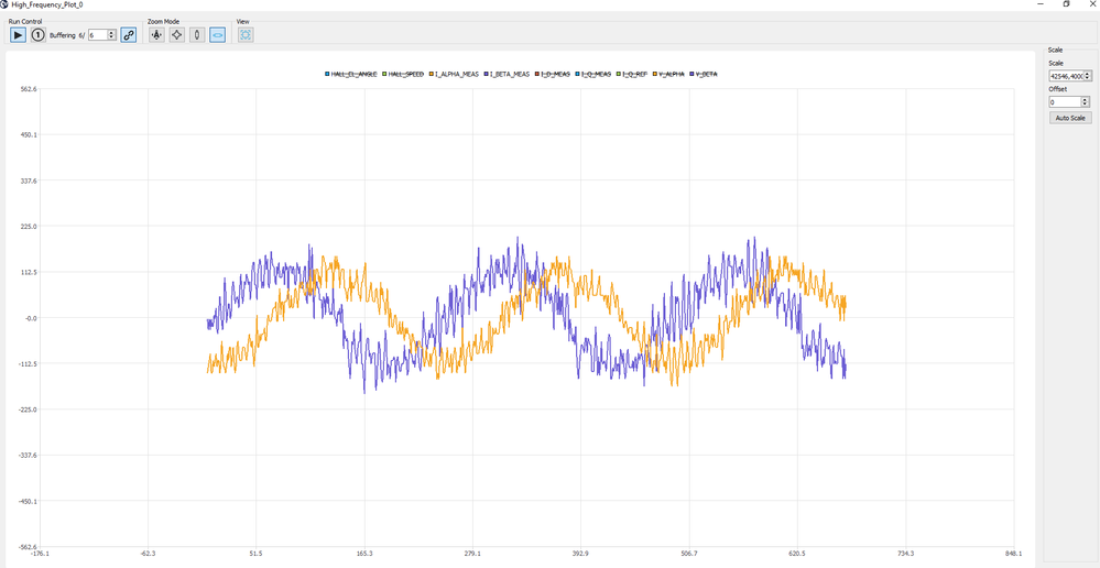

What can cause currents noise in inverter board B-G431B-ESC1?
The measured currents are shown in the attachment.

Ciao
Seems that the peak value of the current is to small respect the full scale.
Try with current 10 or 20 times bigger the signal/noise ratio should be improved.
If you can provide bigger currents to the load then is necessary to adapt the current sensing network maybe increasing the shunt resistors.
Ciao
Gigi
