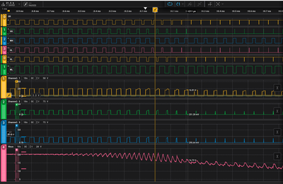

First, even with no command to the motor is looks like the motor control firmware is PWM-ing the fet gates. This is from boot not sending any commands:

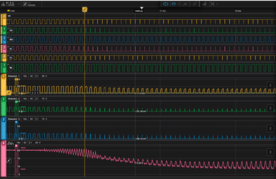

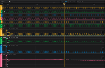

And here are the signals from trying to start the motor with Motor Pilot. This results in a fast torque, then the motor cuts off and i get the Under Voltage fault:
There does not appear to be any pwm-ing of the fet gates, just all on or all off. Does anyone have an idea what I'm doing wrong? I've attached the project files and double checked all signal connections
