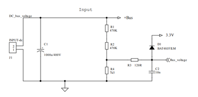

2025-08-15 12:08 AM
Hi, @Zied b.
Is there anything else than the bus voltage divider (126.33) that limits the voltage range to 125V? This divider would give a low SNR for lower voltages. But I can't find anything else in the schematics that would limit the voltage downwards? Also the IC does not specify any lower limit.
2025-08-18 4:56 AM
Hello @Lukas47,
The bus voltage divider ensures that the +3.3V ADC input is not exceeded for the DC bus voltage measurement.
You can use the STEVAL-IPM30B at voltages lower than 125V. This value ensures optimal power board performances.
