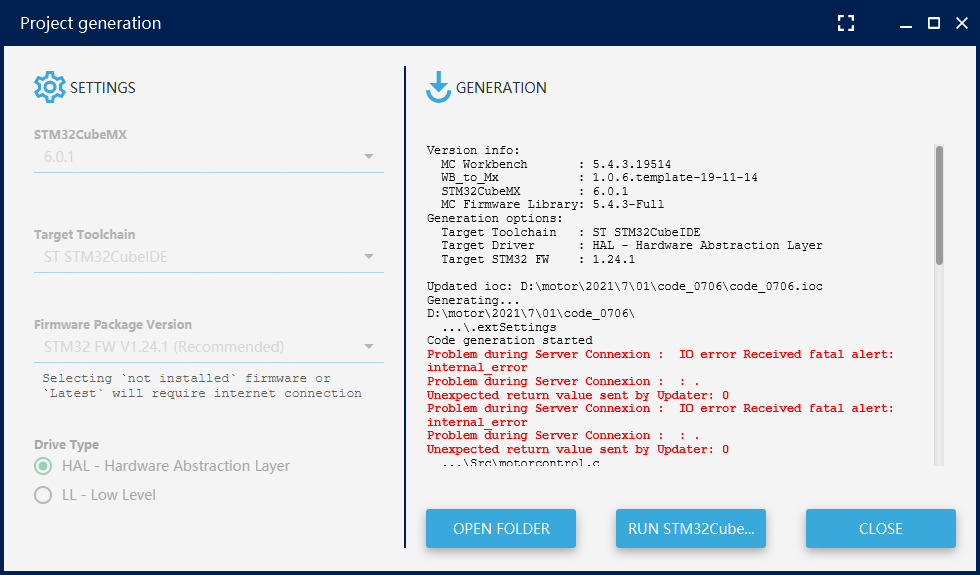

I use MotorControl Workbench 5.4.3 generate code,but it keeps reporting errors,I try many times,I need help.
the error message is as follows:
Problem during Server Connexion:IO error Received fatal alert:internal_error
Unexpected return value sent by Updater:0
2021-07-06 7:53 PM
Dear @lchen.3
It will probably change nothing, but just in case, could you update your STM32 MC-SDK version?
And then please post a new screenshot.
