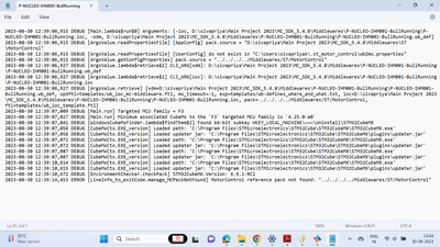

will it work with STM32CubeMX 6.9.1 version, I have the MCSDK version 5.4.8.
2023-08-30 12:36 AM
I'm also encountering the same issue.
The MCSDK version is 5.4.8 and the STM32CubeMX version is 6.9.1
