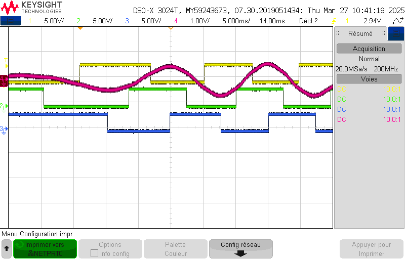

Anyway, I was able also to get the electrical angle offset using the oscilloscope (you can find the picture attached) (which is 120 degree). In addition, I tried to run the motor in Voltage and Current open loop as per the manual. I was able to run it without major problem.

Electrical angle offset how it is 120Degrees. From the rising edge of the Yello Hall signal to the peak of back emf it is around 180 + 60 (i assume) it shall be around 240. Please check.
2025-03-27 4:29 AM - edited 2025-03-27 4:32 AM
Thank you for your reply. I followed this topic: Solved: Is this a 120 or 60 deg displacement angle hall mo... - STMicroelectronics Community that's why I thought it is 120 degrees. In the manual it is written as you have said in your post. I tried with 240 degree it is better but the speed is always constant at 1000RPM however the setpoint is 5000 RPM + the motor sometimes runs and sometimes it blocks or sometimes it runs clock wise and sometimes counter clockwise for the same setpoint
2025-03-27 4:35 AM
I am sorry it is my mistake i got confused
I was referring to the placement electrical angle, the sensors displacement is 120 which is correct which you have entered.
2025-03-27 4:38 AM
No it is my bad sorry. I got confused between the two also

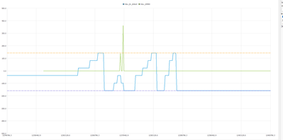

Well, the current control loop is ok (I tuned using Open Loop Current). But when I get to the speed, this where the things are strange. I have attached the evolution of the elecrical angle when I turn the motor by hand (few degrees) and that's what I obtain. It is kind of weird no? The angle is always between 150 and -150 degrees? is it normal?

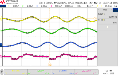

Just for updates, I was able to run the profiler for the hall sensors and it worked. The FOC now with Hall effect sensors is running but the weird thing is that I needed to switch hall sensors H1 and H2 (I knew because of the profiling, it gave an information to swap H1 and H2) and by doing so I got 0 degree as offset. however, I looked into the oscilloscope, the signals are not coherent with the theory. I don't know why it works by swapping both signals. + When I looked on the induced emf when I turn the motor by hand in CCW (as mentioned in the pdf), I have the right phases between phase A, B,C (which is a positive sequence). However, it seems when I command the motor via Motor Pilot, the rotor turns CW.
