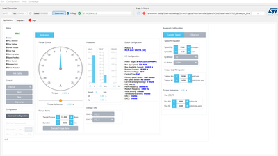

I am using STM32G474RE+IHM08M1 NUCLEO board with FOC library with HALL feedback.
Please find the ST Motor Pilot software tool snapshot after interfacing. for your reference.

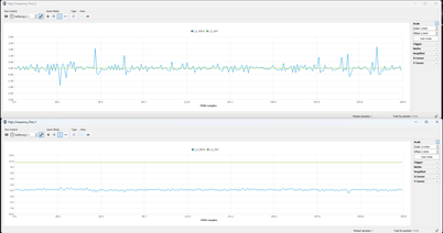

Image2, I have a problem with producing initial Torq on motor coils, as seen from the image attached below I found Torq reference is set to 8A but measured value ranged from +1A to -1A, which is way below the reference value. When I turn the wheel(external force), wheel is automatically picking the reference Torq at that point. I have tried tweaking the Iq and

1. What do you mean by ‘Startup torq issues’? Does the motor start or not? Do you have an error reported? The "Target torque" will be achieved if you add load on your motor. With no load, Iq could be lower and maximum speed is reached.
2. You can tune PID parameters using the MC Pilot interface clicking on the "Advanced Configuration" button.
