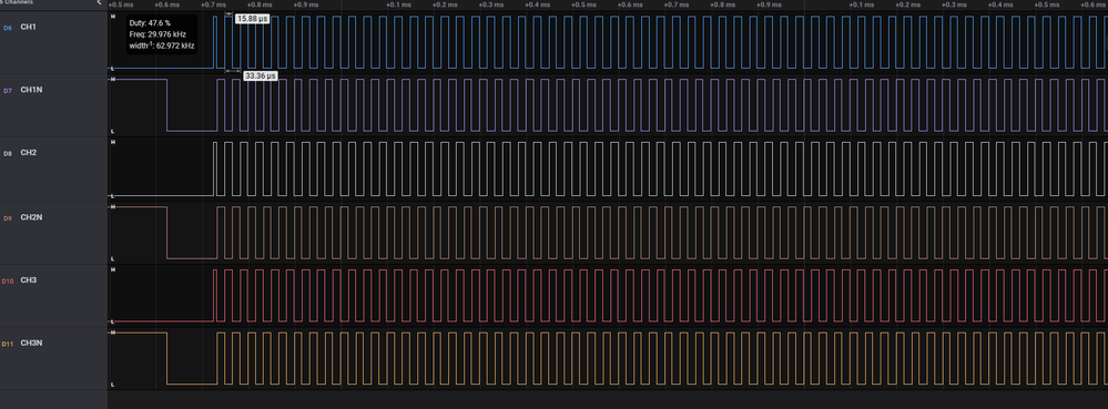

My hardware:
NUCLEO-F446RE + TI DRV8353 demo board(6 x PWM) + ACS725-20AB

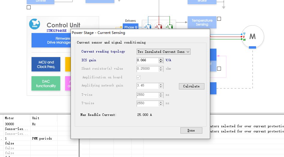

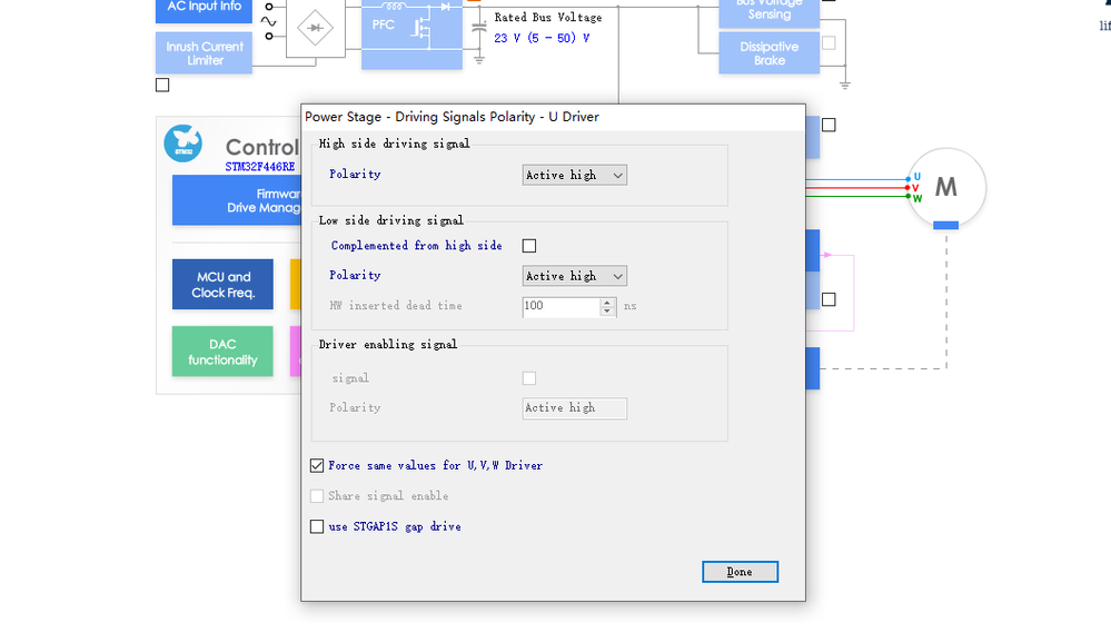

1.I set the Low side driving signal is Active high.2.Set current sensor and ICS gain

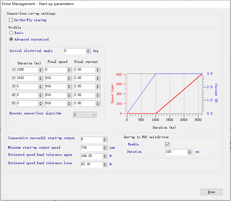

3.Start-up

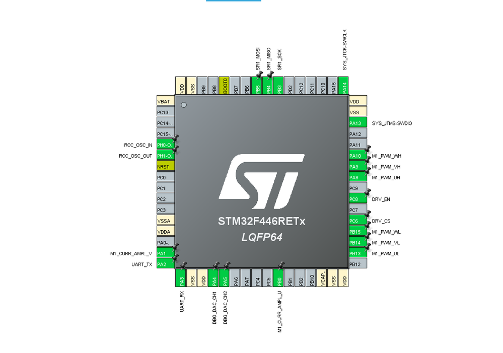

4.Use cubeMX add drv8353 enable pin and spi pin

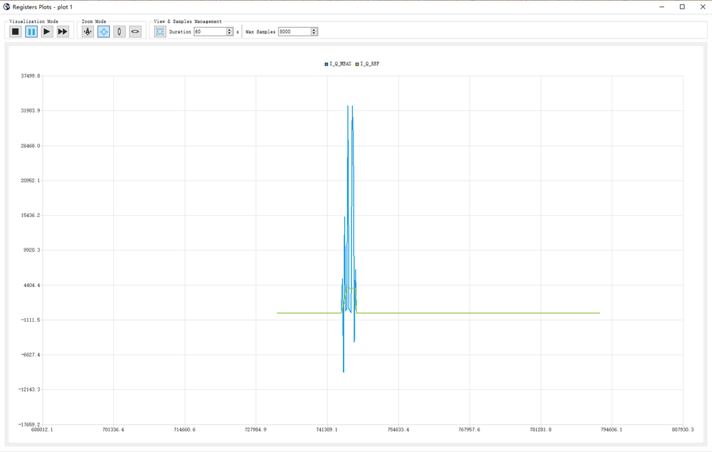

But the motor start error.(It work well in NUCELO-F446RE+IHM08M1)

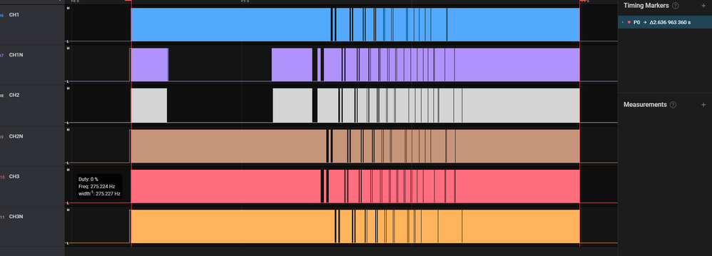

PWM output
If the pwmout 's problem or the current sensor?
