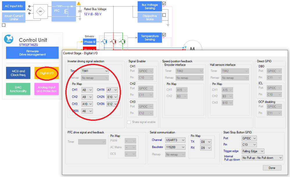

In this case I suggest to check the proper mapping of Inverter driving signal (Digital I/O windows, TIM1 Pin Map):

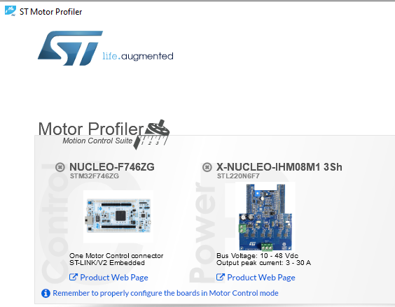

That's a shame that I bought this board as it is listed in the compatible list of the motor profiler (as in the picture below).
In the Motor workbench, it appears that the default pin map is not right as you said. The filter on the Hall sensor on the X-NUCLEO-IHM08M1 is not working properly. The pull up resistor is not on the right side of the filtering. We finally manage to have the motor spinning, not very smoothly for now. And the soft filtering was not sufficient as it appears.

Referring to Motor workbench tests I suggested to check the pin mapping according to your connection between the boards.
Are you using ST Zio Connectors or Morpho Connectors?
Depending on the connection the timer signals (TIM1) must be properly assigned.
Concerning to the Hall sensors signals filters, it is a known issue. You can modify the board as suggested in the Best Answer of this post.
