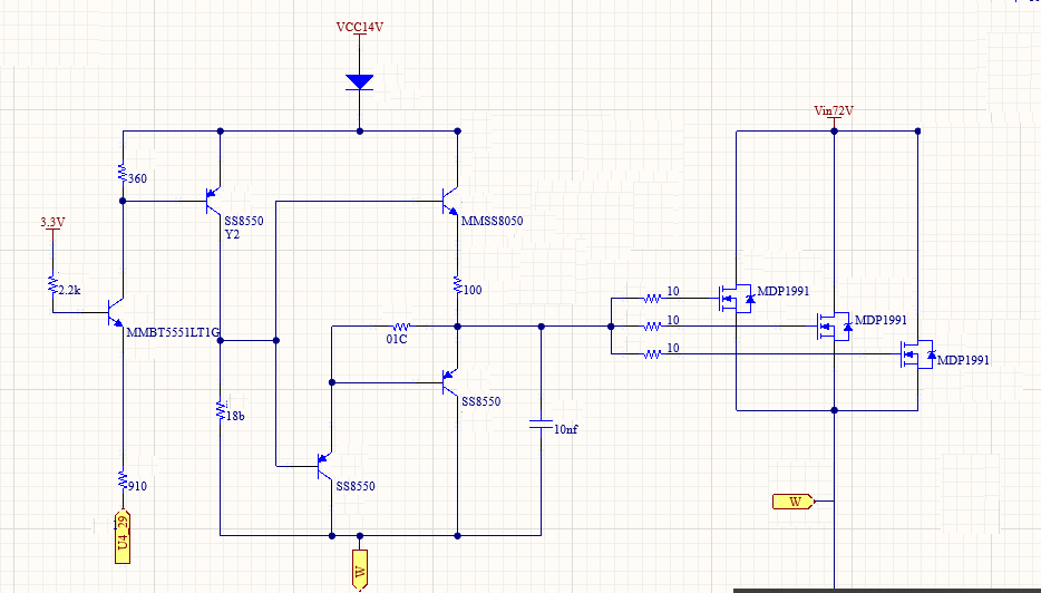

I've had success driving this motor with the same build without a transistor-based FET driver (using an IR2101 driver) and a 5mOhm shunt resistor (otherwise pretty much the same).

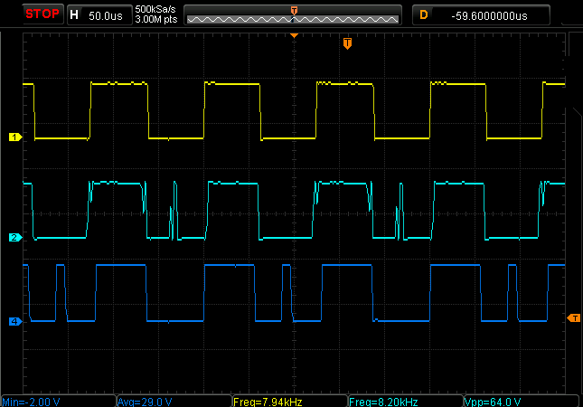

The attached image below shows the output waveform of all three phases, it seems that the waveforms of phases 2 and 3 have unwanted pulses at the beginning and end of the TIM1 period.
Please help me to solve the problem, as you know there are so many parameters to interact with, so I hope to find exactly what's the problem.
