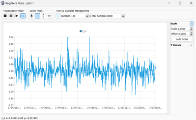

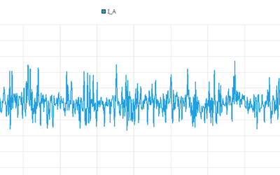

2025-01-16 9:27 PM
I am using a high-speed BLDC motor (47,000 RPM, 24V, 180W) ,

Thank you. I feel like we can get to the bottom of this with enough data.
@hashiR wroteHow can I determine if there is any filtering applied to the current measurement?
Check the schematic. I found there is a first order RC-filter for each shunt resistor. 680Ohm and 100nf. This results in a Cutoff frequency (Fc) of 2340Hz.
The motor is spinning at 47k RPM which is 783Hz. To get the required frequency of the waveforms on the phases you need to multiply it with the number of pole pairs. In case of 4 poles, or 2 pole pairs, that results in 1,566Hz. Which is under the cutoff frequency, but pretty close. It will definitely result in a phase change. I don't know if that's a problem for the controller, but I suspect it might. In that case changing the filter might solve the problem.
The shunt of the IHM08M1 is 10mOhm and that of the IHM07M1 is 330mOhm.
The IHM07M1 uses a different filter type.
The waveform I'm interested in is the voltage on the phases or switching signals in combination with the current. I'm interested in timing of the switching. If it switches at appropriate times. Like I wrote if the motor receives current at the wrong time or DC current it isn't used for torque, but for heating the windings.
