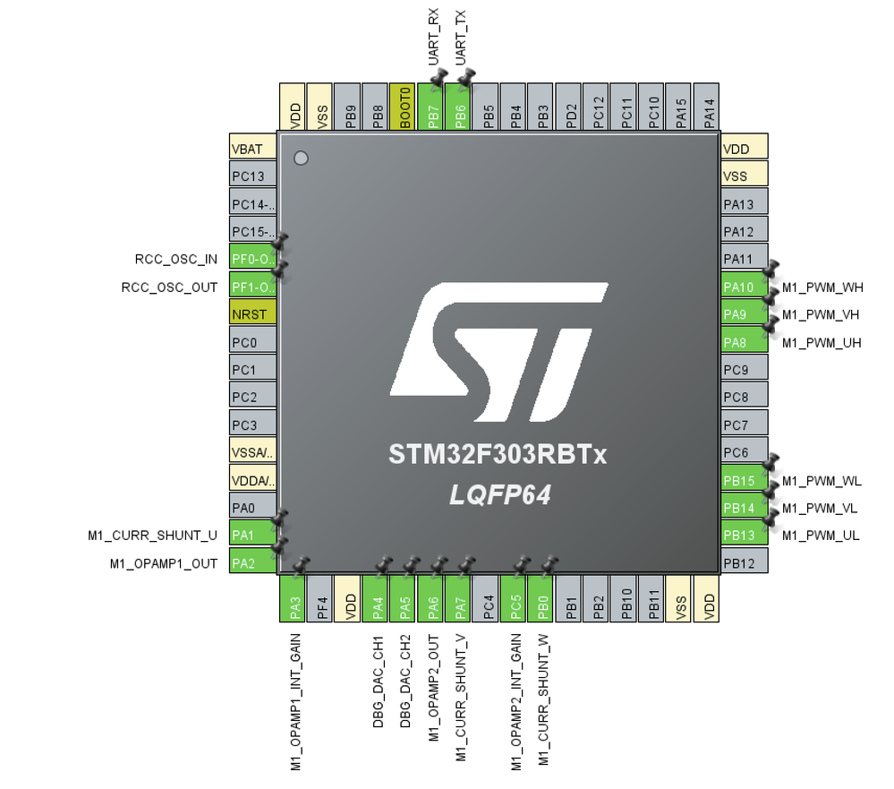

I am working with a sensorless motor with three shunt resistors, and the base microcontroller's configuration definied using MCWB 5.Y.2 is shown in the attached image.
MCWB 5.Y.2 allows me to configure the microcontroller in this way:

Hello @prigh.1 ,
Here is the description file of your board, you can import it on the workBanch as "Inverter", then generate your project.
On the WorkBench, press "new project" then in "Select Motor Control Algorithm & Hardware" choose "Inverter.
click on the button in the upper right corner and add this file in the tool.
To activate the DAC Debug go to the Application Configuration tab of the WorkBench on the left.
Check that you have the right parameters, then generate your code.
After that, open the generated .Ioc file and set the 2 OPAMPs to "PGA Connected" mode.
Finally generate your code and try it.
