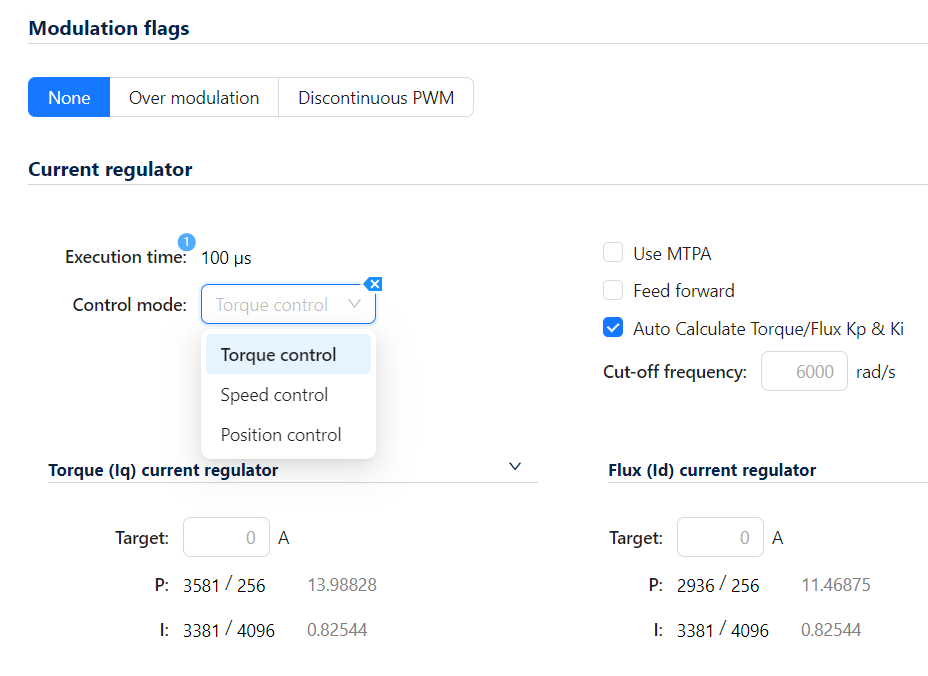

Issue-2: We do not understand which control mode to choose. There are 3 control mode namely, Torque Control, Speed Control and Position Control. So, what are the expectations from these control modes. Among Torque and Speed control mode there is no change/improvement observed for lower rpms issue. In Position control mode the lower rpms are better than the other two control modes but, the motor is vibrating, making noise and heating up.

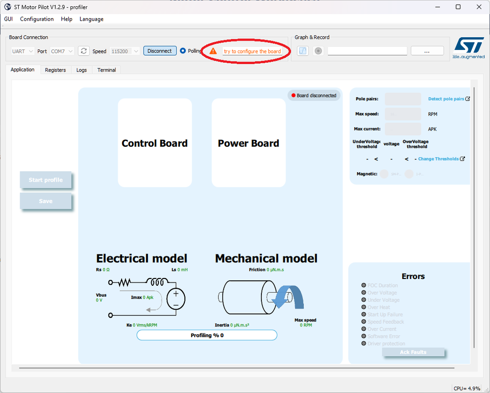

Issue-3: Why 'Graph' option is disabled in Motor Pilot? Can't we use this feature in this eval board?

Issue-2: Speed or Torque mode depends on how you want to control the motor. Position Control mode is described in documentation available through "Workbench tool">About>Documentations>Documentation, "user Manual" tab, "Position control" link.

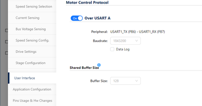

Issue-3: Graph is disable according to the unselected "Data Log" option by default:

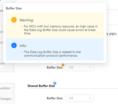

If you enable it, take care of warning message: "For MCU with low memory resource, an high value in the Data Log Buffer Size could cause errors at linker time.".

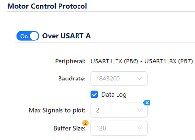

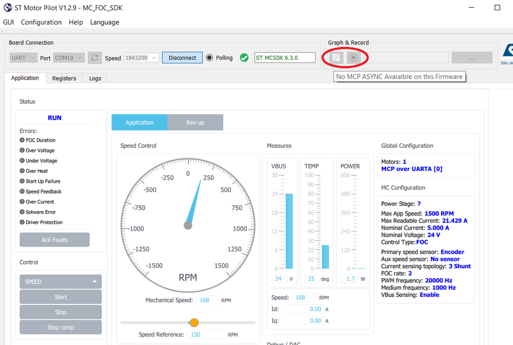

To enable the 'Graph & Record' option in the Motor Pilot, I enabled the 'Data Log' option.

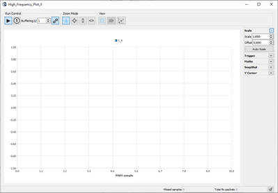

Now, the 'Graph & Record' option is enabled in Motor Pilot but, when I am adding a signal to the graph it doesn't plot anything.
And, an error pops up at the bottom of the Motor Pilot window.
Is this because the following warning message?
If so, then the buffer size selected (128) is the minimum possible value.
Can you please suggest how can I add a signal to the plotter window in this scenario?

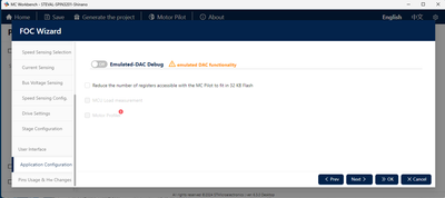

Please try by de-selecting the "Reduce the number..." option.

Hi @GMA
I tried by de-selecting the option you had mentioned.

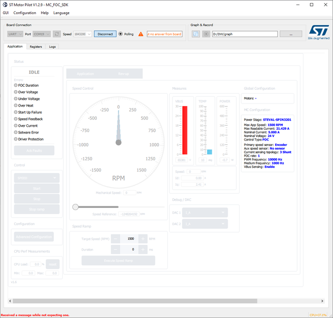

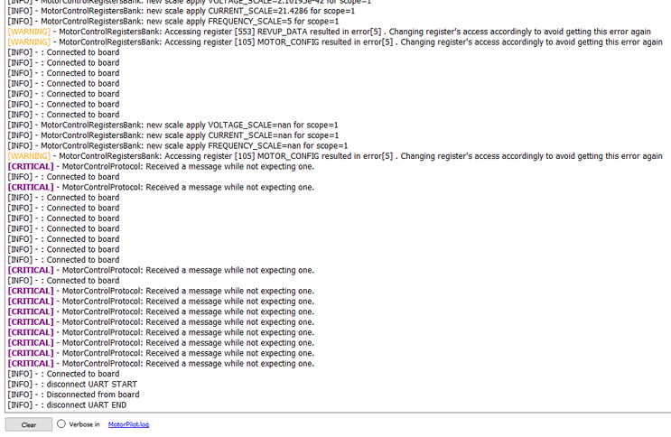

Now I could see the plot in the graph window, but I guess frequent connection/disconnection are happening so the plot is sometimes stopping and restarting..
The log window show some warnings too!
Sometimes Motor Pilot is not responding and plotter stops to plot signal!
