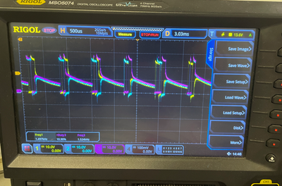

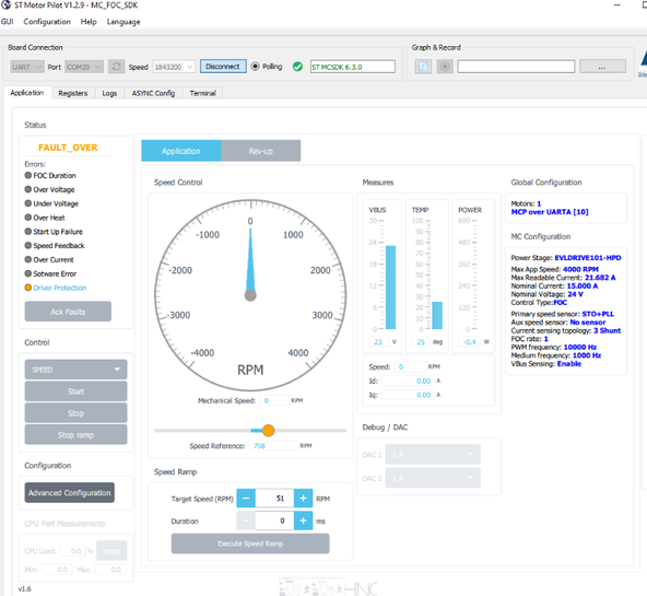

Update: I managed to connect to the MotorPilot. But the issue still remains. Where the motor does not turn, it tries to on start up, but all it does it a little jerk. Giving the following result:
"Driver protection fault", i couldnt find any info about this on the user manual, what could i do to troubleshoot this fault? On the phases outputs, the PWM signal appears to be in sync on start up, then turns off when in "fault_over" status.
After seeing this, i turn driver protection off to see what happens. And the motor does a similar thing, but remains in start status mode a bit longer. it produces the following profiles on the three phases profiles to the motor (see photo). This makes the motor jerk but not turn at all.
Any advice on what to do? Thanks,

Hello @mitch1,
"Driver protection" is the error generated by STDRIVE101 Driver, please refer to UM3257 documentation, 4.2 Current sensing chapter and check if your application current level e.g. corresponds to "default threshold".
You can also have a look to User Manual documentation available through "Workbench tool">About>Documentations>Documentation>"User manual", "Firmware errors" link, "2. Over Current" chapter.

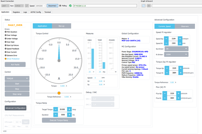

2024-07-23 4:28 AM
Hello @mitch1
did you try to reduce the current target to a value below 15A during the open loop period to see whether the motor can be accelerated without incurring in a protection fault?
You can do it both in the motor pilot (rev-up secrtion) or in the workbench (Sensorless start-up parameters)
Alessio

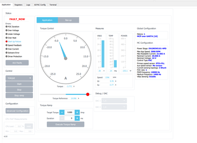

2024-07-23 6:21 PM
Hi Alessio,
I reduced the current to 5A and it is giving me the same fault. See screenshot below.
It also produces no PWM signal during this unlike the previous tests.
However, it looks like the driver protection fault is caused by the over voltage in VBUS. i turned that off and the fault changed but the motor remains still.
