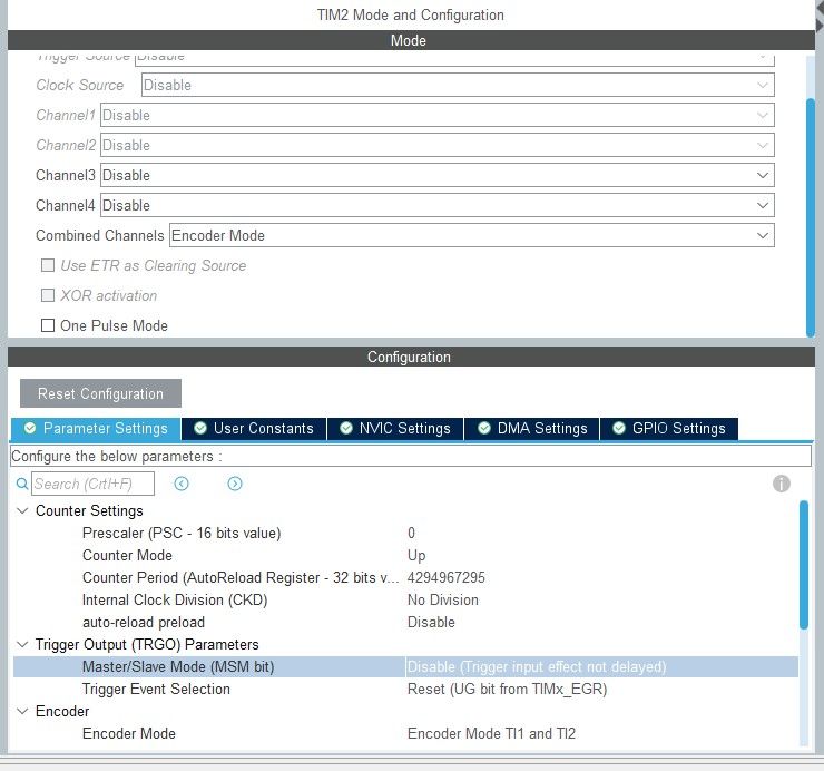

This is my TIM2 config so far:
So I guess I need to set Trigger output -> master/slave mode to enable?
What about the other settings ?
