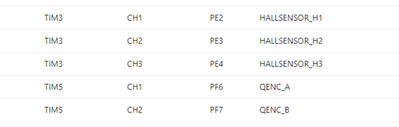

I have checked the next MCSDK6.2 release (release coming in a few days on st.com), and there is a combination of boards (control: B-G473E & power: STEVAL-LVLP01) that will allow you to generate a project using both sensors.
example:
But please note that this configuration has not been validated.
However, it may assist you in building your own project by comparing it to the generated project.
