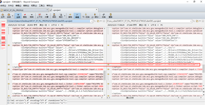

Hello @GMA ,
I repeat as your description and compile success. I notice that "STM32 FW 1.6.1", maybe this is the point, I always used "STM32 FW 1.6.0", and always had compile error. I compare the output folders and found this, screenshot below, left side is 1.6.0 and right side is 1.6.1. Thanks for your help!
