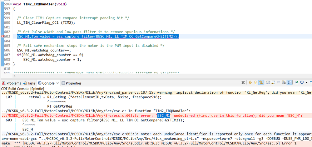

I opted out of adding this these lines, as it seems to create additional redundant files in the project. As a result, after transferring the configuration and files, I got the following error:
Which I fixed by adding the following code (found in the example) to the "mc_config.c" file:
