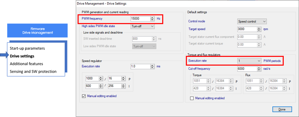

Anyway, if you want to use the debug mode without optimization, there is something you can do on the FOC parameters.
The first suggestion is to reduce the PWM frequency of the power stage (look at the picture below).
The MCU has more time for the FOC calculations during each PWM cycle.
Try using 15kHz for example, but consider that reducing PWM frequency can lead to less performance at high motor speed.
The other thing you can try is not to change the PWM frequency but the execution rate.
Execution rate =1 means that the firmware does the calculations every PWM cycle.
Changing the execution rate = 2 will help: the calculation will be done once every 2 PWM cycles giving more time to the microcontroller.

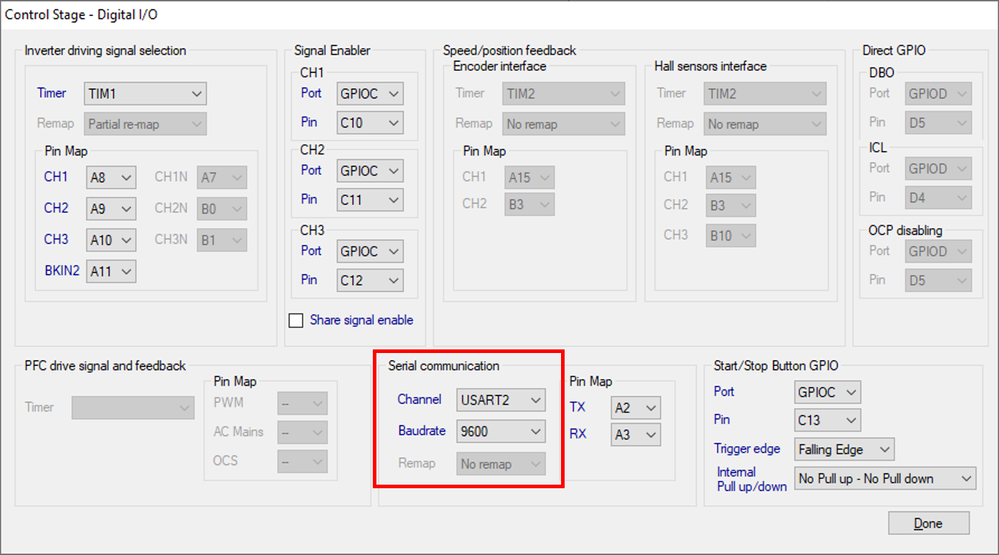

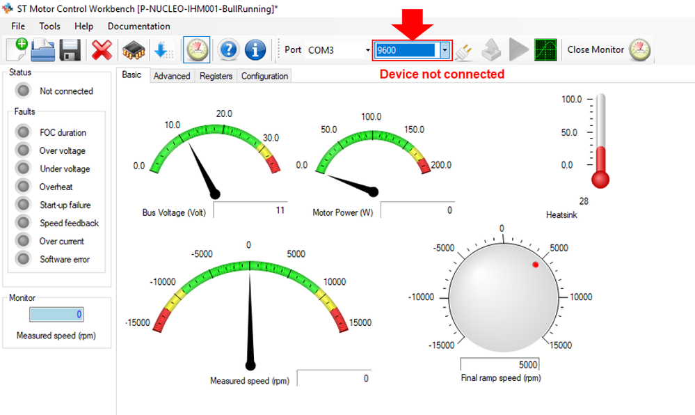

Then, in my experience also reducing the baud rate of the UART interface (if used) can help.
Use 9600 as a baud rate, it is not so fast but in many applications is enough.
Then remember in the monitor to set the same baud rate when communicating with the board.
