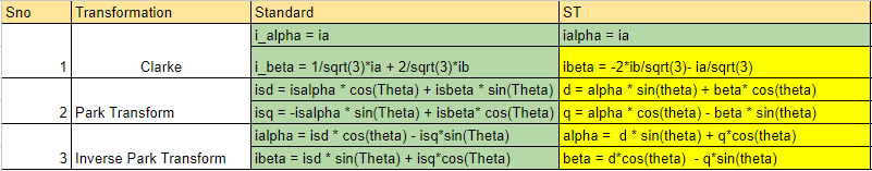

2023-04-17 2:46 AM - edited 2023-11-20 8:02 AM
Thank you for feedback i have few doubts if you can clarify it will help me a lot.
The clarke, park and inverse park transform have different formulae compared to standard i have attached the image
Could you please help me to explain why there is difference?
