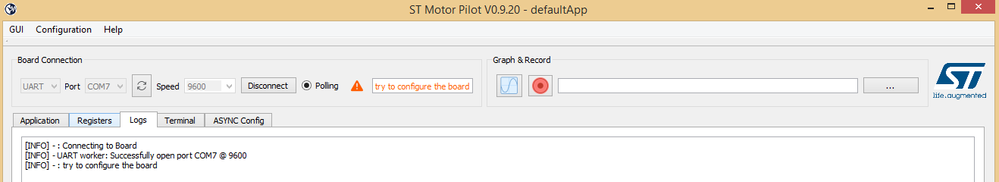

I return to ST MC workench (ver 5.Y.4), and I click on "motor Pilot"
When I click on "connect" I obtain this answer:
It is written "try to configure the board", and in the application, all is grey, I can't use it.

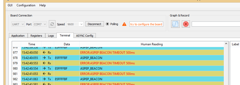

In the terminal windows, I have this:
What must I do??
Can you help me please?
