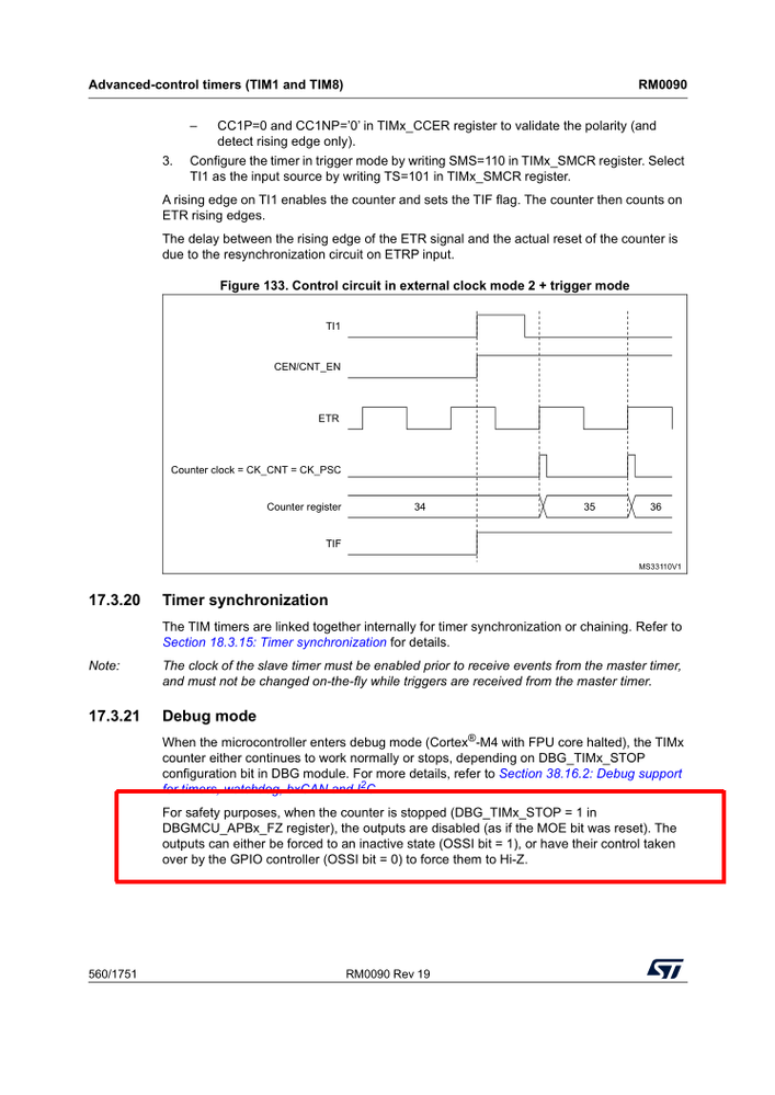

Hi @waclawek.jan,
I am indeed talking about this. The Debug Mode seems to exist on all timers (usually described the last sub-section of the functional description of the timer. However, the safety behavior you mention is not. You can find it on Advanced Timers, HR Timers and some GP Timers of the STM32F3, F7, G0, G4 and H7. It is not present on F0 and F4. I did not check the other series.
BR
Fred
2023-02-21 8:13 AM
Thanks, @Fred V. .
Indeed, RM0091 for 'F0 does not mention it, but:
I guess you've checked some other 'F4 then the "classics" covered by RM0090, in which case determining whether this feature is or is not present may be more tricky than I thought...
