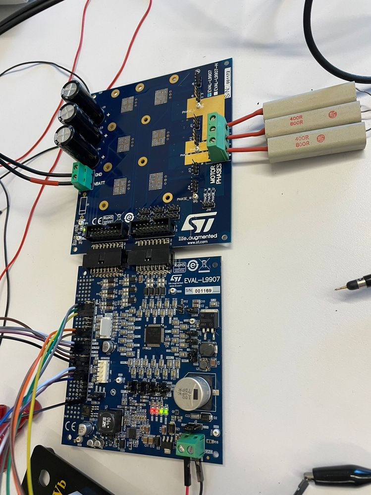

My group in university got the L9907 Eval board to drive a BLDC motor. All jumpers on that board are set with default option. We have the problem, that the L9907 does not work as expected. The outputs of GHS_1, GLS_1, GHS_2, GLS_2, GHS_3, GLS_3 are all 0V. But we connect a pwm signal to PWM_H1 and PWM_L3 and enabled both EN pins (EN1, EN2). Furthermore the boost circuit is not 10V higher then the consumption. Is there any more step to do before this chip works?
Thank you in advance
More info:
