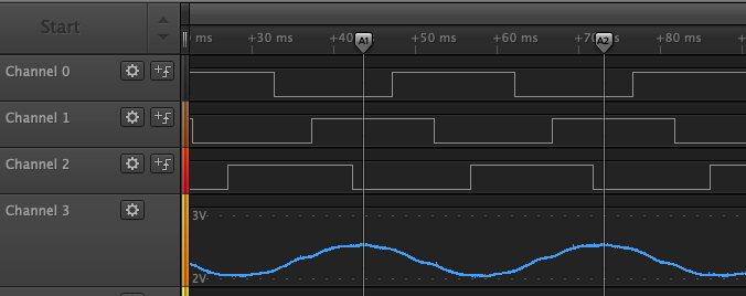

Hello forum! I am trying to characterize a motor for experimentation with the workbench. I spun the rotor with a hand drill and got the following waveform, with the first 3 channels being H1, H2, H3 and the analog voltage being the back-EMF from the motor phase C. It looks to me like this is a 120 deg phase offset between each hall sensor, and since the channel back-EMF is 22 deg AHEAD of the H3, the placement electrical angle should be -22 deg, in the workbench motor parameters. Do you think I am misunderstanding the definition of the these values?
Thanks for reading.
Note the actual form factor of the hall sensor is within the 60 deg region of the stator.

If channel 2 is H1, channel 1 is H2 and channel 0 is H3 then hall sensors are 120 degrees electrical apart. Mechanical placement can be within 60 degrees physically. It is the electrical displacement that matters.
What is the reference for the channel C BEMF waveform capture? Is it with respect to motor star point?

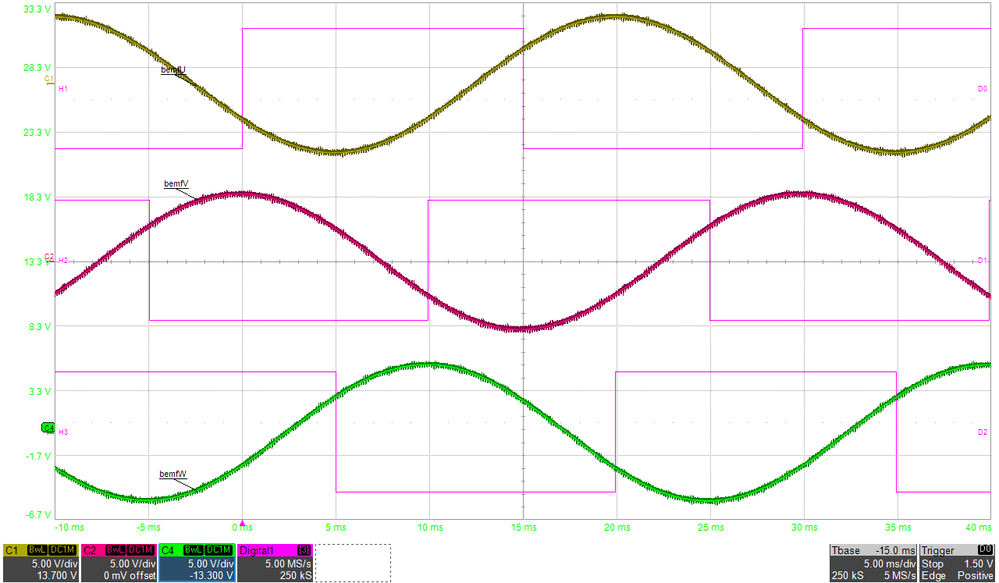

Look at this example:
You can see, for this specific motor, the BEMF is lagging 120° the H1 positive edge: so in the workbench the “Placement electrical angle�? must be set at 120°.

In the example I provided the sequence is:
H3 rising edge, H2 rising edge, H1 rising edge so in this case the motor is rotating in the opposite direction.
Since we have an opposite direction, we also need to revert the phase shift calculation so:
from the first rising edge of signal H1 to the maximum of the B-emf induced on phase A.
Now I realize that this picture could be misleading , so thanks for your clarification :grinning_face_with_sweat:.

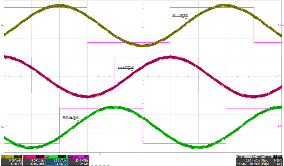

I took the same motor of the previous acquisition and I did an acquisition making it spinning in the direction shown in the user manual UM1052.
As you can see now measuring from the maximum of the B-emf induced on phase A to the first rising edge of signal H1 I get 120° as in the previous case: and this the value to be set in the "Placement electrical angle".
Sorry if I wasn’t clear from the beginning, I hope now it is ok.
