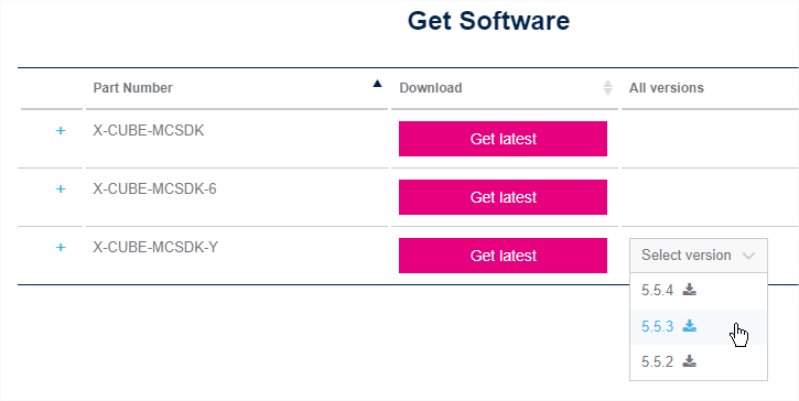

After working with FUL_5.Y.2, I need some of the features offered in 5.Y.3.
I believe I clicked on the 5.5.3 version when downloading. Is 5.5.3 actually 5.Y.2? Or did I misclick? I did have trouble downloading, as my browser crashed and sent ~12 requests .

You are right, the version is visible as "5.5.3".
After passed the "Agreement" and "Get Software" process, I was able to download "en.X-CUBE-MCSDK_5.Y.3.zip" file.
