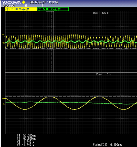

According to AN4144, page 14/28, the coefficient 'ke' is measured by turning the stepper and measure the phase voltage with a oscilloscope. For the coefficient 'ke' in V/Hz, which voltage normation should be used:

2023-04-26 7:37 AM - edited 2023-11-20 7:06 AM
Hello Cristina
To clarify - do you mean the Peak to Peak voltage or the voltage from Ground to Peak (half of Peak to Peak). Or to refer to the measured signal in the oscilloscope screen: 1.74 V or 3.48 V?
2023-04-27 1:56 AM
Hello @MBaum.2gartner,
I mean peak voltage so in your waveform 1.74 V ;)
