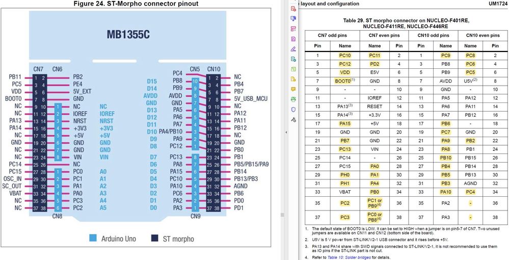

thanks for the suggestion. Unfortunately UM2435 is focusing on BLE and 802.15.4 applications and do not mention motor control. Based on it I can just do the following comparison between Morpho connector on Nucleo-WB55 and Nucleo-F401RE (ref. UM1724):
where I highlighted any different signal. Nevertheless this is not enough to define how to setup X-NUCLEO-IHM17M1 stacked on P-NUCLEO-WB55 instead of NUCLEO-F401RE.
