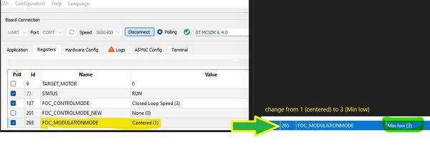

For testing purposes, it is possible to modify the modulation mode through the register interface using the ST Motor Pilot GUI, as illustrated in the figures below:
If this meets your requirements, you can update the default modulation mode directly in the firmware code (mc_config.c) by modifying:
.modulationMode = FOC_MODULATIONMODE_Centered,
to either:
.modulationMode = FOC_MODULATIONMODE_MinLow,
or
.modulationMode = FOC_MODULATIONMODE_MaxHigh,
for your information the supported modulation modes are:
FOC_MODULATIONMODE_Sine
FOC_MODULATIONMODE_ShiftedCenter
FOC_MODULATIONMODE_UpDown
