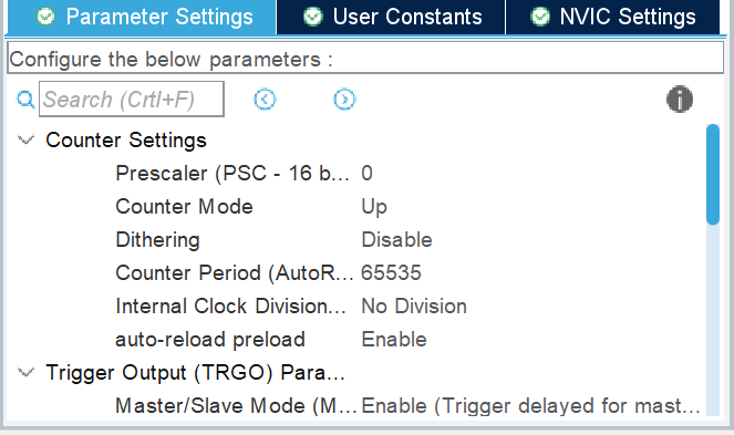

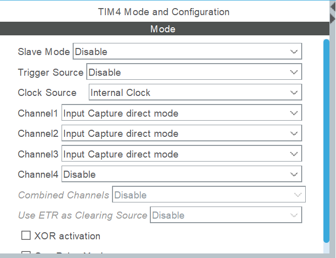

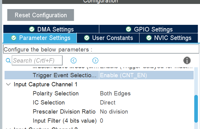

I am using timer 4 in STM32G431 to read hall sensor input and trigger interrupt when high .
Above is my setting.

2021-12-15 6:09 AM
How do you know this code has _hallA = 0 or 1? This value is read from CCR1, not set. How are you "changing" that value?
"If" statements work correctly.
2021-12-15 6:16 AM
void HAL_TIM_IC_CaptureCallback(TIM_HandleTypeDef *htim)
if (htim->Channel == HAL_TIM_ACTIVE_CHANNEL_1)
_hallA = HAL_TIM_ReadCapturedValue(htim,TIM_CHANNEL_1);
if(_hallA != 0x00U) -----here i check hall is 1
TIM1->CCR2 = 40000; ------ this is the value for Timer 1 CCR1
else
TIM1->CCR2 = 10000;
-> Do you mean I should check CCR1 value of timer 4 instead of hallA value?
2021-12-15 6:37 AM
Yes, I can see the check is in your code. Your logic in the if statement matches what you want to happen. However, the value used for that check (_hallA) comes from this statement:
How do you know that function is returning 0 or 1?
