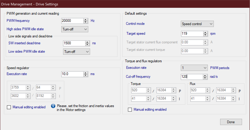

I am trying to find the correct PI controllers parameters for my E-Scooter application. Initially, I determined the parameters of the motor through the Motor Profiler, but now I wondered what inertia should be specified. The inertia of the engine idle is quite small, but when the E-Scooter moves with a passenger, the inertia of such a system is many times greater. Since the calculation of PI controllers depends on this, I would like to better understand how I should calculate it. I am also interested in the cut-off frequency parameter, since I have a low-speed application of only 500-600 rpm max, which frequency should I set if I do not need high-frequency pulsations that may arise during control.

Hello, yes I would still like some clarification on how to set up the Motor SDK for electric scooter motors where there is significant system inertia at start up. The motor with Hall sensors starts well at idle, but under load, the torque is very weak.

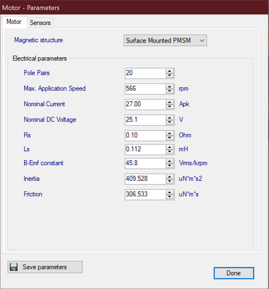

By the way, the units of the inertia and friction identified by the Motor Profiler are of the order of few "micro". This seems very low and not very plausible. I wonder if this is a typo...

I have also some questions about Motor Profiler results.
We profiled a motor with to less parameter specifications. During profiling the motor was rotating fine.
With the profiling file we made a new project for a different inverter.
When we start the motor in Motor Pilot the motor is starting CW but after a while it switches to CCW. Finally, it stops due a USB connection failure with the control board.
See attached video (result,zip)
Anybody an idea how to solve this?
For the moment I have some doubt about the profiled inertia value.
The value is extreme low and the units are strange.
Anybody a idea how to validate the profiled value?
