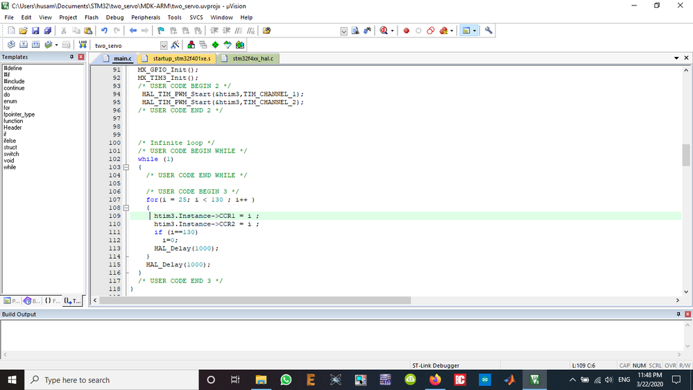

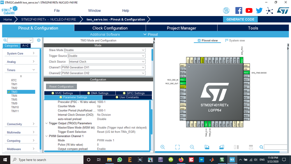

the servo motor doesn't move at all . just there is a tik tik voice but no move i dont have oscilloscope to see PWM output signals
