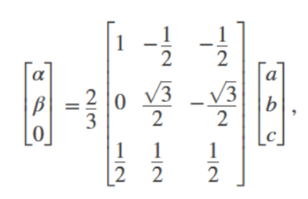

I am analyzing the FOC algorithm using motor control workbench 6.10.
During the analysis of the FOC algorithm, I do not understand the MCM_Clarke function part.
In the case of Clarke transformation I know, it is an algorithm that converts three axes into two axes. However, at mcm, it seems to convert two axes into two axes as shown below.
alpha = a
beta = -(2*b+a)/sqrt(3)
Maybe I can get some help?

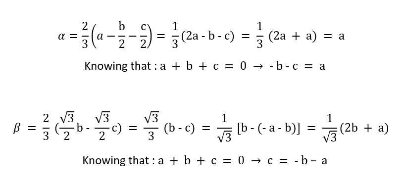

The answer relies on an additional equation : a + b + c = 0, which we use to remove any c value from our results to depend only on a and b values. This is why you might at first think MCM_Clarke converts two axes into two axes and not three axes into two axes.
Developing my point, we start with :
which gives :
We find the values given in MCM_Clarke function.
Hoping this will help,
Gaël A.

Thank you.
I thought about the above conversion for a long time.
But, I didn't think of going crazy with the rule of a+b+c=0 and substituting it for this formula.
Your a+b+c=0 core solved everything.
I'm much obliged to you for your help
