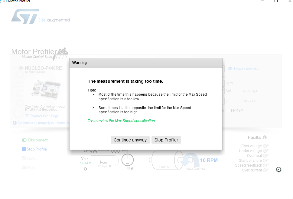

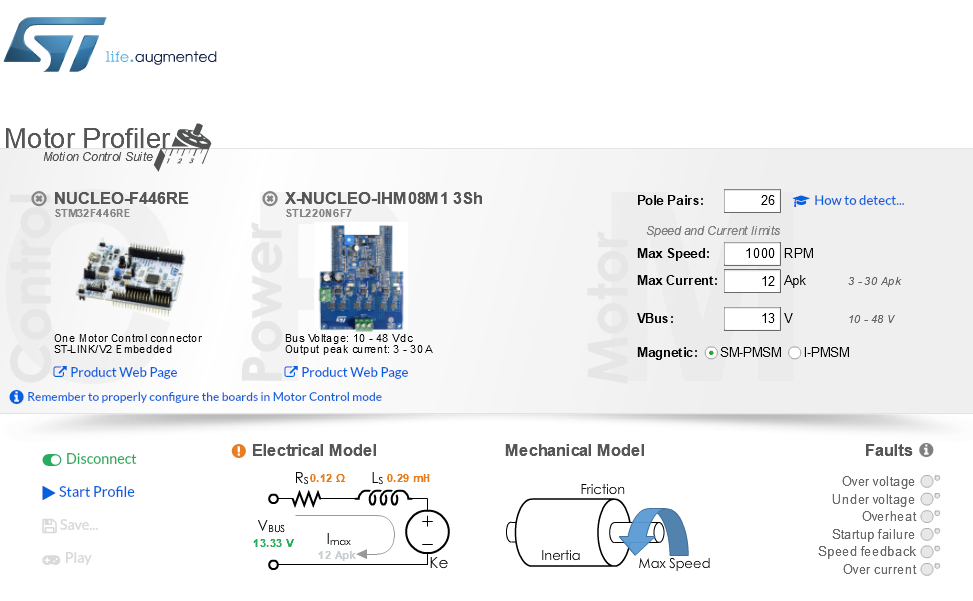

I am using X-NUCLEO-IHM08M1 NUCLEO-F446RE Motor Profiler 5.4.8 motor>>48v 600w not run
somkid
Associate III
0693W00000Un8ovQAB.pngI want you to help explain and help fix it.0693W00000Un8pUQAR.pngMotor 48 volts, 600 watts, number of pairs of poles 52/2=26
or the motor is too big, please reply, thank you very much.

jartim
Associate III
There is a design fault on the IHM08M1 (at least on the 3 units I have) where the switch-mode converter does not start when Vbus is greater than about 12V. The output from this switch-mode drives the output driver enable signal, so there is not FET drive when Vbus is more than 12V, hence the test never works. This may not be the cause of your problem, but it is a good place to start.
