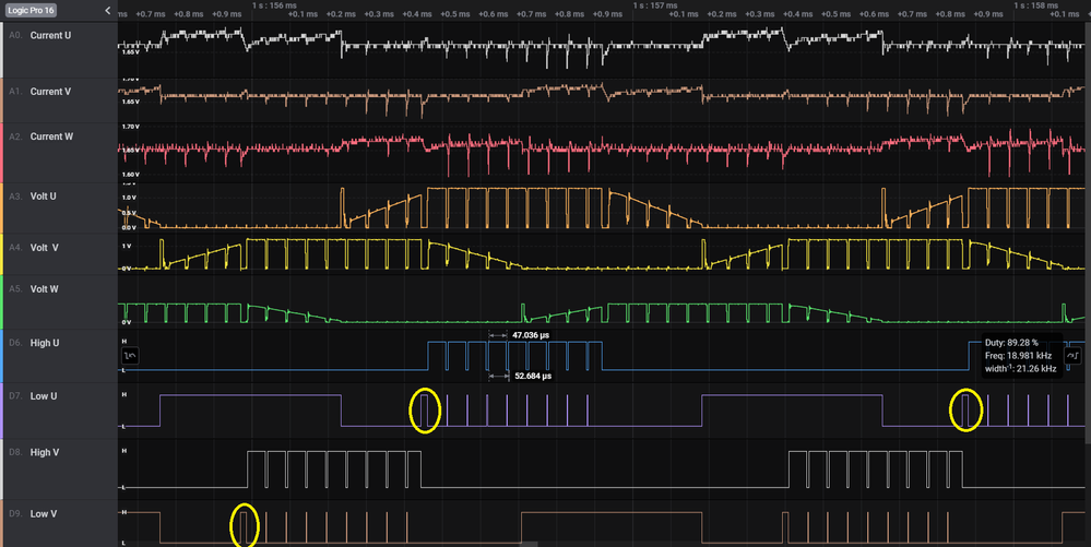

The captured PWM signals with back-emf’s and currents are shown in the figure below (waveforms are recorded using Logic Analyzer). The pulse causing the problem is highlighted in yellow.
I did many work-around to solve the problem but could not find a solution. I would really appreciate if anyone can give some idea to tackle this issue.
Figure explanation:
The first three waveforms are the phase currents, followed by three back-emf’s and PWM pulses
In the figure,
'High U' is the PWM pulse on high side of U phase
'Low U' is the PWM pulse on low side of U phase
'High V' is the PWM pulse on high side of V phase
'Low V' is the PWM pulse on low side of V phase
In the test the motor is running at no-load, duty cycle is 90% and switching frequency is around 20kHz
The IGBT module used: FAM65V05DF1
The BLDC motor used: T-Motor U15
