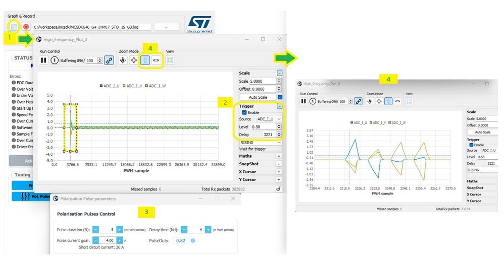

PolPulse Tuning Steps (example attached for ref):
1- Probe the 3-phase currents with an oscilloscope or Motor Pilot GUI.
2- Set the trigger to capture current at startup.
3- Set the pulse current goal based on the motor (default: ¼ of short circuit current), considering hardware limits.
4- Gradually increase pulse duration (N) while ensuring Pulse Duty stays below 0.98.
Verify the four pulses are generated correctly. If needed, increase decay time (Nd) to space pulses properly.
If several start/stop cycles run successfully without issues, the PolPulse tuning is complete.
